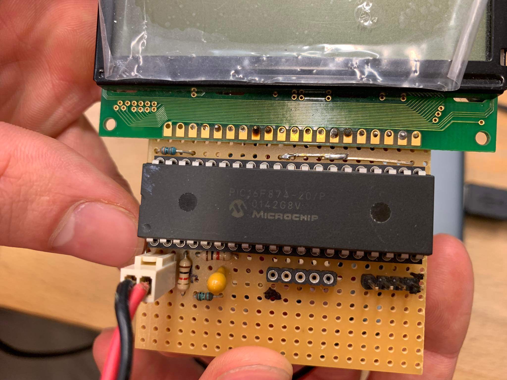

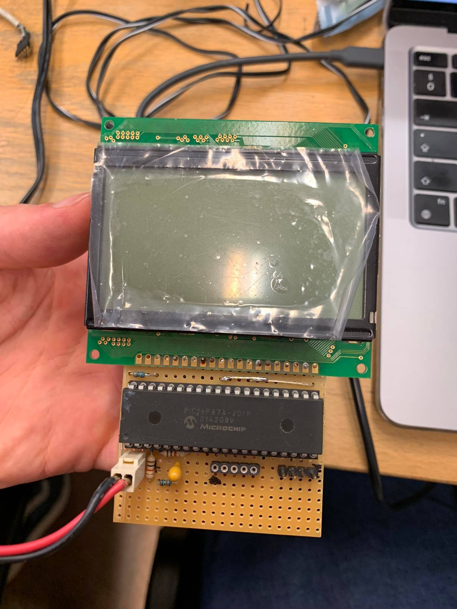

Dear Members! At university we were given the PIC16f874(-20/P), microcontroller shown in the picture, connected to an lcd display, and we were given the task to draw a logo on it. We've only learned similar things, but nothing like this, so we're having a lot of trouble getting the project done. We are using MPLab 6.0 and a program called pickit 2, into which we copy (or would copy, if we had it) the hex code from MPlab. So far, after much digging, we are trying the configuration bits, but no luck. Can anyone help? Suggest articles or anything. Also, if there is something I have not described, please let me know.

Can you show us the code you have?
What has worked for you?
Can you program the MCU at all? If so can you do something like toggling a GPIO pin (the 'flash a LED' type task that shows you can get a very basic piece of code to work)
That LCD display looks like it is a graphics one - correct? If so do you have the data sheet for it so that you know how to initialise it and drive it correctly (they are sometimes not easy to get started)?
Looking at the solder joints to the display board, some seem to be 'dry'.

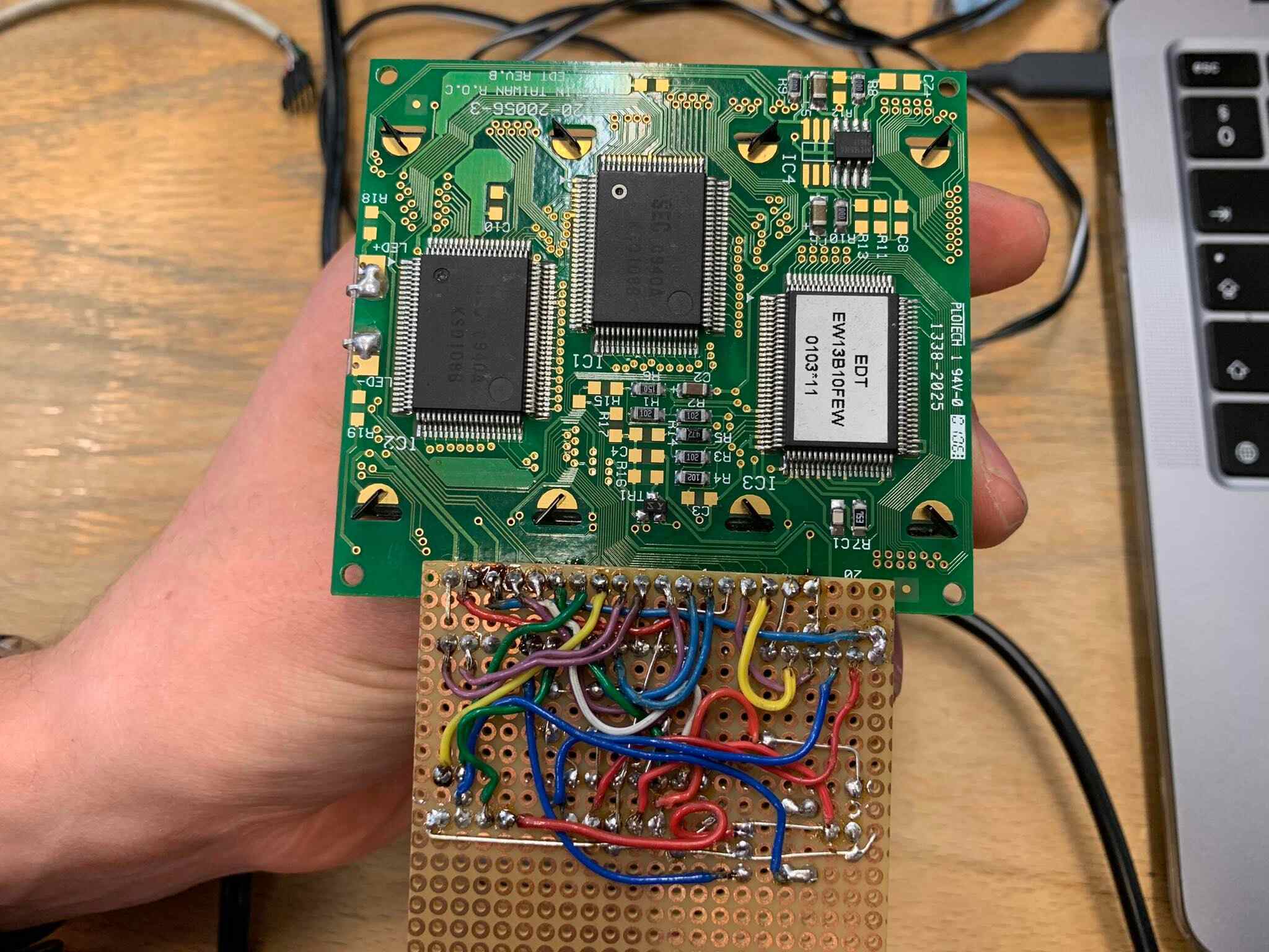

I found the display: "20-20056-3 Lcd models display"
umogi_lvr
Posts: 8
Joined: Thu Dec 01, 2022 3:51 pm
Re: PIC16f874 project
Postby umogi_lvr » Fri Dec 02, 2022 12:34 pm
with this: EDT EW13B10GLY

Are you able to show us the datasheet for the display? The ones that Ii can find on the web show the hardware interface but not the protocols for initialisation etc. that you have in your 'lcd.c' file - these are critical at getting most displays to work.
By the look of the code in 'lcd_init()' you are using the HD44780 protocol but that is for a character displays (often 2 or 4 rows by 16 to 20 character) and not a graphics display which I what I think you have. Are you sure that is correct (which is why I was asking for the initialisation protocol datasheet etc.)
