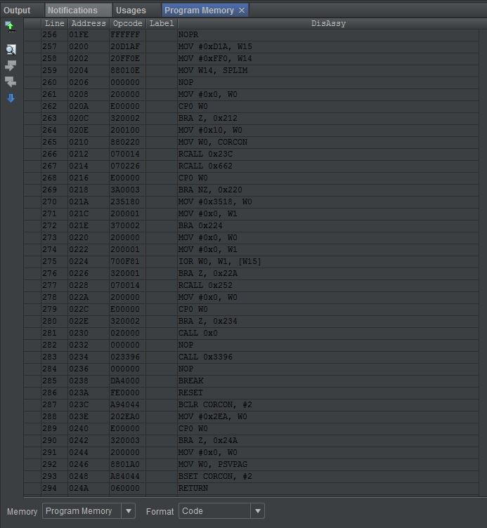

Retrieving the code written to compile/assembly the hex file I think is an impossibility with only the binary hex file to go on.
However you CAN import the hex file into MPLAB X and see the code in the program memory:
Program Memory.JPG (66.41 KiB) Viewed 16955 times
To do this, in MPLAB X, File > Import > Hex/ELF (Prebuilt File)
This will import the hex file into a new project. From there, Window > Target Memory Views > Program Memory
