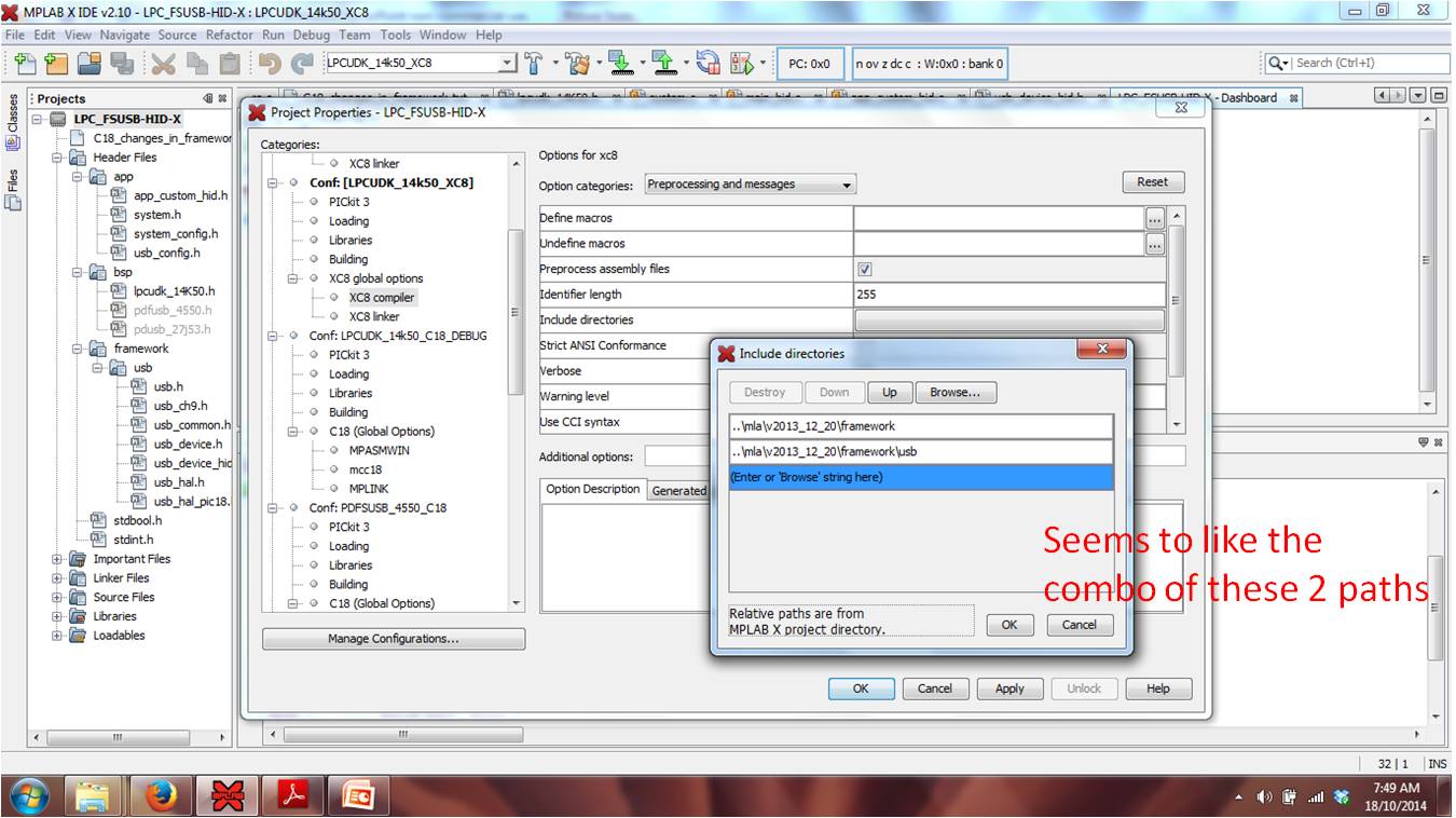

I think I finally cracked the include path!!! well complier is not shouting at me any more!!
The path shown in .jpeg VlokiUSB2 is to the mla within the project folder.
(still don't really understand the "go up 6 levels" )
C:\microchip\mla\v2013_12_20\framework (I only count 5 levels to and including "framework")
E:\PicProjects\PicUSB\USB_Vloki\LPC_FSUSB-HID-X-r1\src\mla\v2013_12_20\framework (I only count 8 levels to and including "framework")
Can you please explain

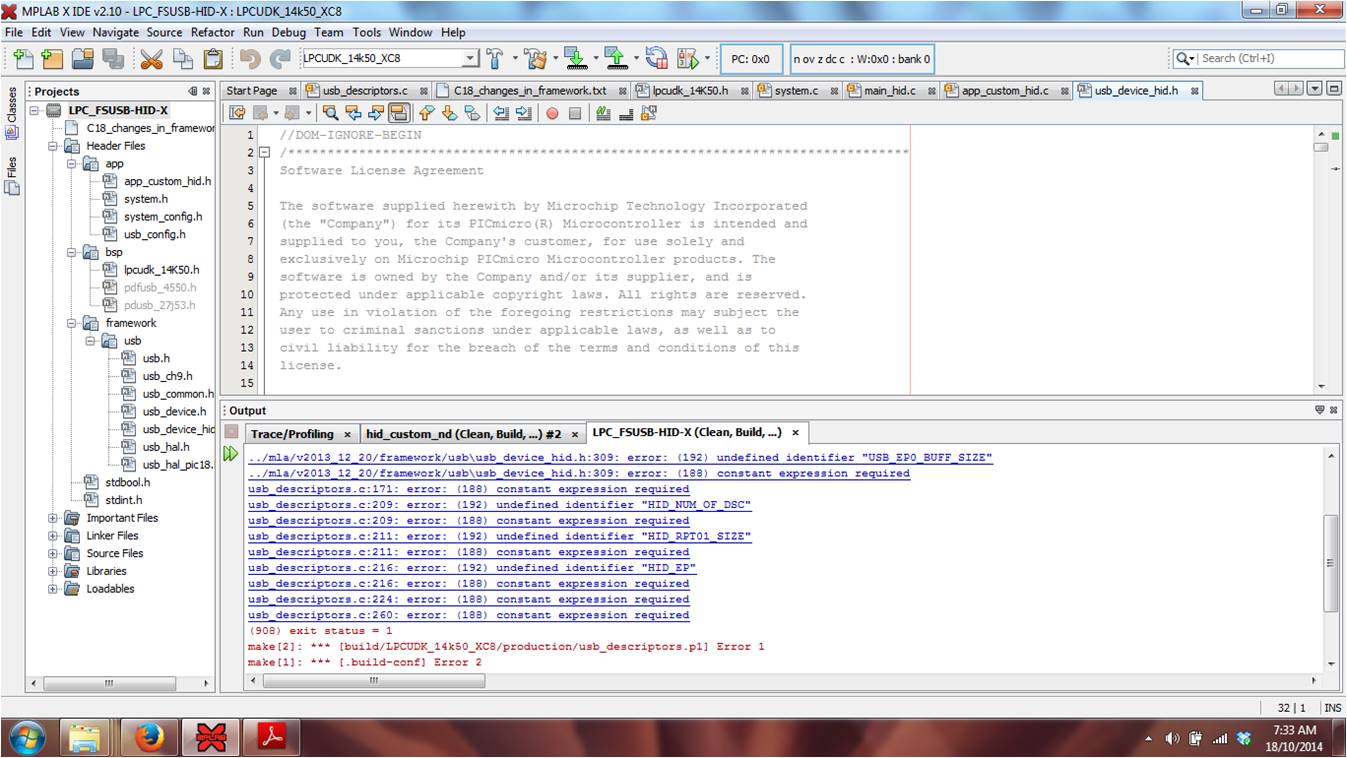

But now I have a few compiler errors ...please see attached pics.
I've also attached the zip of the project file.

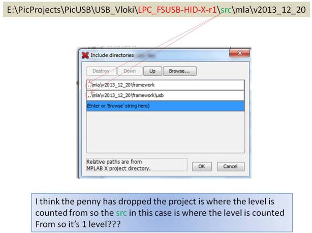

Postby Interrupt » Fri Oct 17, 2014 11:26 pm
I think the penny has dropped with the include path level thing.....please see attached .jpeg and please enlighten me if I'm wrong!

Re: Simplified Microchip PIC USB demos (C18/XC8 MLA v2013_12
Postby vloki » Sat Oct 18, 2014 8:14 am
No ;-)
The project directory is ...\src\LPC-FSUSB-HID.X.X
From there you have to go one up to come to src -> "..\"
From "src" you go down to mla -> "mla\v2013_12_20\framework"
"..\" + "mla\v2013_12_20\framework" -> "..\mla\v2013_12_20\framework"
