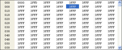

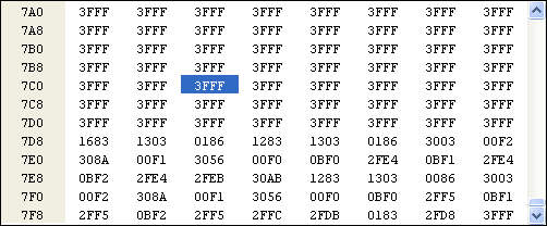

When I import hex, it displays 3fff all the way down to the second last line and the program seems to start there but there is only one line of memory left.
Turns out when I tell it to "write", it writes the program and it works but it is very discomforting not to see the hex file as I am used to seeing it.

Postby K9ACT » Sat Jun 28, 2014 4:57 am
vloki wrote:
K9ACT wrote:When I import hex, it displays 3fff all the way down to the second last line and the program seems to start there but there is only one line of memory left.
js
This sounds *a bit* unlikely ;)
Did you try to view your hex file in an editor ?
May you post one ?
I have attached screen shots of the first and last page of the Pickit 2 hex display and
the following is a Word view of the hex created by the code from ric.
The program loads and runs in hardware.
js

Postby Ian.M » Sat Jun 28, 2014 6:08 pm
Nothing surprising here. The six lines of the HEX file that are in the FLASH program memory area match the two PICkit 2 memory screenshots.
The first line of the HEX file is a NOP followed by GOTO 0x7FD
The subsequent five lines of the hex file are a block of code located between 0x7D8 and 0x7FE
Then there is a line giving the CONFIG word and the final line is an end of file record, both of which don't appear in the program memory.
This is exactly what I would expect if the compiler is using a top down FLASH allocation strategy, and you have the NOP at address 0 for hardware debugger support and you are using my ROM range patch to prevent bogus address wraparound errors in the simulator.
You'd better read up on IntelHEX!
