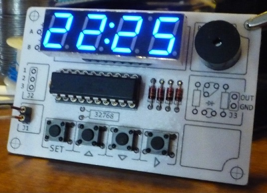

Have you had an opportunity to study the code in projects published on the internet? I got a lot of great examples and ideas (and some not so great examples) this way when I started many years ago. I also found lots of code examples in the PICLIST source code library.
I've published a few beginner projects like the one pictured below but the programs were written in C so I'm not sure they would be very good examples for you.
Good luck on your project.
Cheerful regards, Mike
