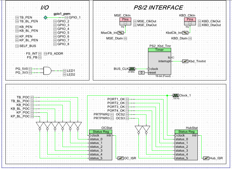

I've started using the Cypress PSoC devices over the past couple years and I've been pretty impressed with them. It's definitely easier to get up and running than using a PIC32 with Harmony from what I've found. The PSoC gimmick is that the MCU is an ARM code with programmable analog and digital hardware space inside (like an FPGA). You connect and configure the components through a GUI (almost like laying a schematic out). It generates the HDL and interface for your components and gives you an API to work with in your C code.
Maybe not perfect for every application, especially if you really like getting your hands dirty in the registers, but it's really nice to be able to just lay out whatever components I may need, and just put them out to nearly any pin I want. It's been a real godsend in some situations like "We need this output to come out of a different pin!" or "We need to invert this input" because you can do it through hardware rather than software. It's nifty.
I recently built a PS/2 Keyboard and Mouse to USB HID adapter with it, here's a page of it:
