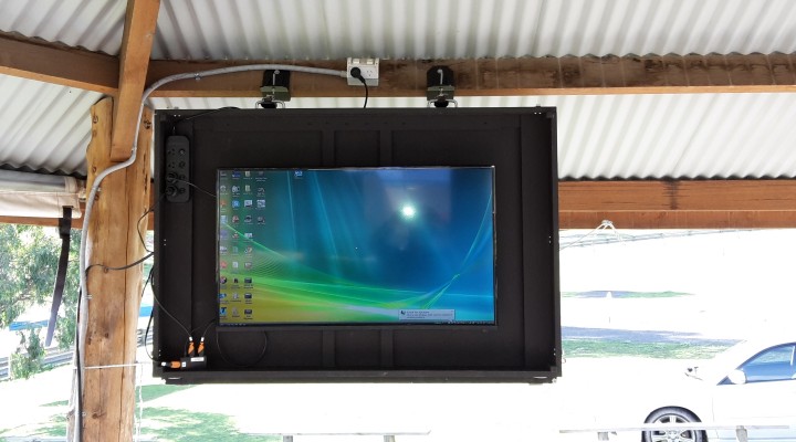

Here's what the current screen looks like (it's 1024x768 pixels now, but the Pi and screens can all ramp up to 1920x1080)
The two big grey rectangles are standard Microsoft List boxes that get filled in line by line with driver run times.
You can see there's plenty of room to mount a RBP next to the screen. :)
(That's a 42" HDTV. The cabinet is oversize because there is a 55" one on the other side.)
