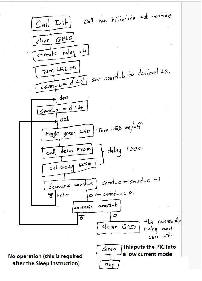

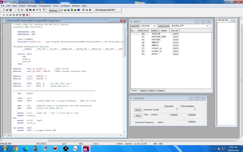

I programme using Assembly language. I prefer it to other languages. Draw a flow chart first, then open MPLAB & use the Project Wizard to start the project. I use MPLAB 9.2. I never bothered to use MPLABX. I have attached a text of the Programme is a sample of one of my programmes. It is a 3 hour timer using the 12F675. It is a copy of the B&D Charger.asm. (This forum does not allow .asm files to be attached.)
I'll post the flow chart later.

I have attached a flow chart & a screen shot of the MPLAB screen.
