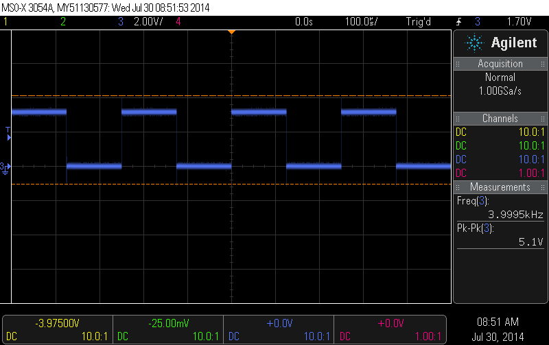

Postby yubyub » Wed Jul 30, 2014 1:54 pm
Just a visual for those who love pictures. Excuse the slight ringing/overshoot, it's my fault, not the circuit nor the scope.
4KHz square wave working.
