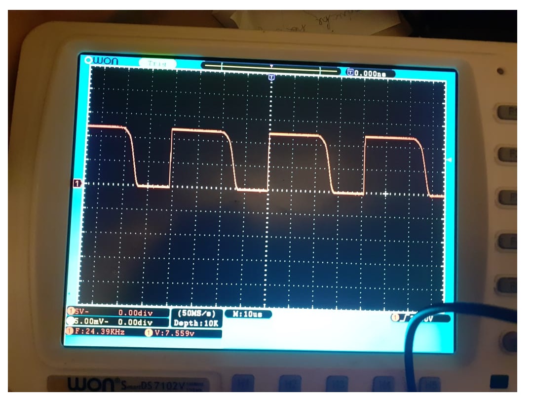

If the period is given by PR2 plus 1, which would be 256, the duty cycle is very small, but when analyzing this signal with an oscilloscope, the duty cycle is very long, greater than 50% of the signal period.
Any suggestion of what's up?
I attach an image of the signal displayed on the oscilloscope and a capture of the registers T2CON, OC1RS and PR2.
oscilloscope
T2CON, OC1RS & PR2

I forgot to add the value of OC1CON. It is 0xC006

We have discovered the problem.
We verified that in the hardware that was prototype that works without problems, after careful review, it was discovered that the problem was the optocoupler that drives the CMOS transistor.
Although it is high frequency, it doesn't work as indicated by the manufacturer.
It seems that we received a batch with some problem, but it seems that it is a counterfeit of the original chip, since we did not buy them from a recognized supplier.
