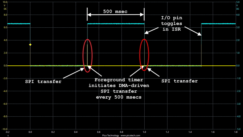

The transfer is initiated every 500 msecs from a timer operating in a foreground loop.

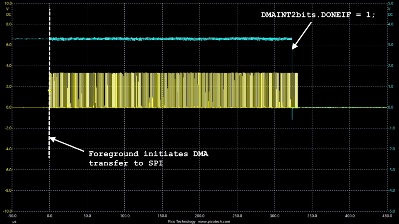

The process is initiated every 500 msecs. 72 16-bit data are transferred out using a SPI clock of 3.3MHz, or 0.3 µsec/clock, 4.8 µsec/16-bit DMA transfer; the entire transfer takes ≈ 350 µsec. The debug I/O pin only toggles once per transfer, demonstrating that the ISR only fires once when the DMAINT2bits.DONEIF event occurs:

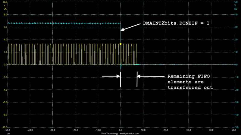

Here is an expanded view of the SPI transfer. Note the SPI clocks continue after the DMAINT2bits.DONEIF event occurs:
LED DMA and SPI.1.2.jpg (206.23 KiB) Viewed 68349 times
This is because the DMA is filling the SPI FIFO so SPI operations continue after the data is completely transferred out of RAM:

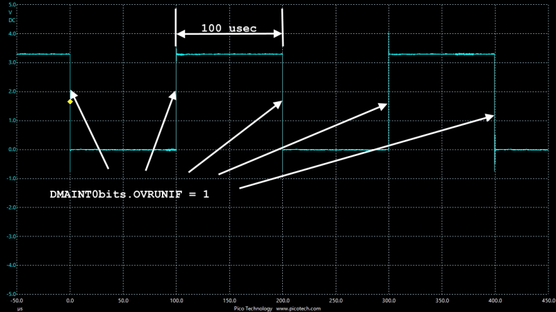

The problem is that unlike Method #1, when this code runs it generates an overflow error on every single transfer:
LED DMA and SPI.3.2.jpg (185.14 KiB) Viewed 68349 times
In Method #1 only 1 interrupt is generated at the end of the transfer sequence.
In Method #2 an overrun error is generated for each transfer.
The only difference is the triggering mechanism.
Note that Method #2 successfully transfers the data from ADC0/1 to Buffer[]0/1. The problem is the overhead incurred by firing 2 ISRs (DMA0/1) every 100 µsec.
