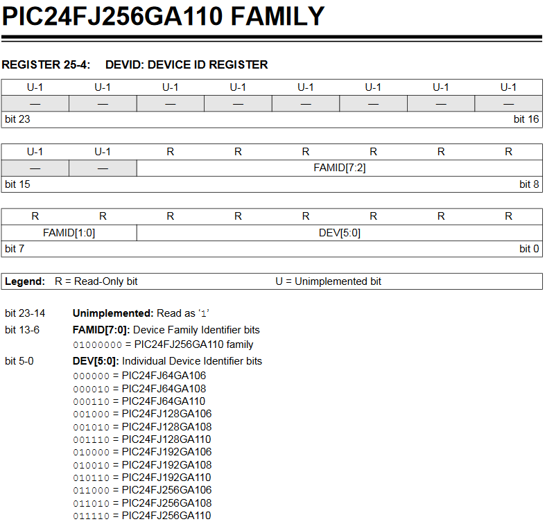

Depends on exactly what you mean by Unique ID.
Do you mean something that identifies the part specifically as a PIC23FJ128GA106? If so you're looking for the DEVID register, which is on page 252 of the datasheet:
If you're looking for something like a Serial Number that is unique to every IC, I'm afraid you may be out out of luck. You can buy serial number ICs though if you need a serial number. I've used this one before:
