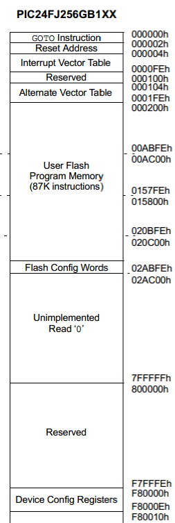

jtemples wrote:I looked at my old bootloader and I didn't do anything with interrupt vectors. Maybe they remapped the interrupt vectors because the vectors are in a protected boot block that couldn't be written by the bootloader. If that's the case, you wouldn't have to use the protected boot block if you didn't want too fool with interrupt remapping.
In this memory map which memory is boot protected? Starting from 0x200h ?

Postby HallMark » Fri Jul 25, 2014 6:33 am
@BobAGi, Vector table is from 000004H to 0000FEH and for my SIM900 bootloader code starts from 000200H and I allocate say upto 001200H and then from 001400 I start my application code. So when I want to change my application I just have to erase part from 001400H and update them with new received code. Isn't this going to work?
