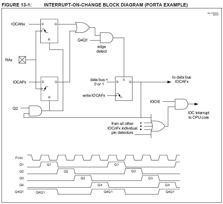

I've been working with interrupt on change on the PIC16F1777. The data sheet says, "In order to ensure that no detected edge is lost while clearing flags, only AND operations masking out known changed bits should be performed." Does that mean there's actually special silicon related to the AND instruction that avoids the race condition when clearing flags? The data sheet doesn't say that explicitly, and in the general case, an AND isn't going to do anything special to avoid clearing flags that shouldn't be cleared.

Looking at Figure 13-1
The latches top left are reset on Q2 if the matching IOCAF bit is already set.
The IOCAFx latch only gets set on Q1 or Q4.
I would guess the AND operation is taking place on Q3, avoiding the race condition.

That makes sense, since Q3 is the "modify" cycle.

If it works as ric described, then everything is taken care of in hardware, and it does make perfect sense. I don't see any reason why AND or any other particular instruction should be used. BCF should work just as well.
