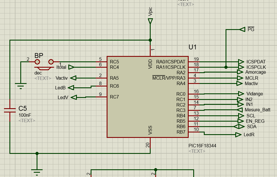

You need to read up on the difference between the INT (external interrupt - Section 8.4 of the data sheet) function and the IOC (Interrupt On Change - Section 15) function. Wile you enable both interrupt sources, you only handle the INT source.
However, the comments look like you expect the INT source to be triggered when you push the button. (I've already mentioned that you need to handle contact bounce in the other thread.) As you have not altered the PPS defaults, the INT function is on RA2 whereas your schematic shows the button on RC2.
Please take the previous advice and start slowly. You can getting yourself into a whole lot of problems because you are trying to do more than your current state of knowledge will let you. The learning curve can be quite steep at the start but once you can 'flash a LED' at the desired frequency then you are over the worst and you can progress fairly quickly from there.
