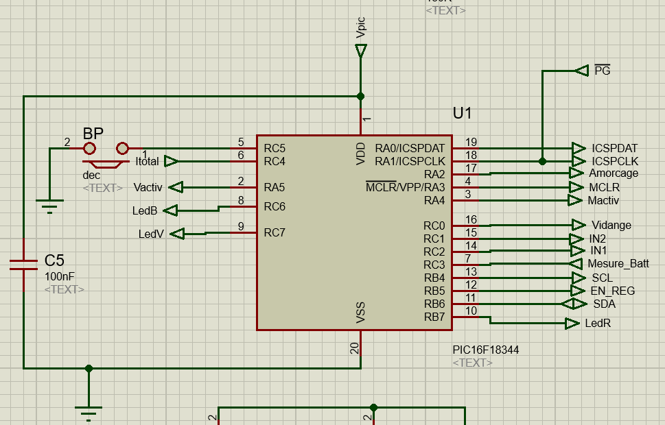

Hello everyone,
I would like to make an interruption with a push button and an LED. I do not have much control over interruptions. Here is my current code but the problem is that my push button does not work when I make a support. On the other hand, the LED remains on. Thank you in advance ! :)

I see you have changed your interrupt handling, but it is still incorrect.
        PIR0bits.IOCIF = 1;
        PIR0bits.TMR0IF = 0;        // RAZ flag IT
should just be
        PIR0bits.IOCIF = 0;
You have enabled three separate interrupt sources, but only put code in your ISR to handle one of them.
As suggested on the Microchip forum, you should start with simpler code which just reads a pin, and writes the result to an LED.
The key to efficient debugging is only work with one unknown factor at a time. Don't try to debug multiple things all at once.

On a separate topic, you should follow another rule of thumb.
Use PORTx registers to read inputs. (e.g. PORTA, PORTB, PORTC)
Use LATX registers to write to output pins.
So
#define ledR RB7 // +LED rouge
should be
#define ledR LATB7 // +LED rouge
Now, as a first test, do NOT enable interrupts. So
INTCONbits.GIE = 1; // Valide les interruptions generales
becomes
INTCONbits.GIE = 0; // Valide les interruptions generales
then, change
    while (1){
to
    while (1){
        ledR = BP;    // copy push-button status to LED
and confirm that the LED changes with the push-button.
Once you know the push-button and LED are working correctly, you can move into interrupts.
My next rule of thumb is, it is very rarely a good idea to use interrupts to detect a push-button at all.
Only do it if you are going into a very low current sleep mode where the interrupt must wake up the processor.
In all other situations, poll the push-button state in a timer interrupt. anything from 20 to 100 times a second.
That makes it much easier to work around "button bounce".
