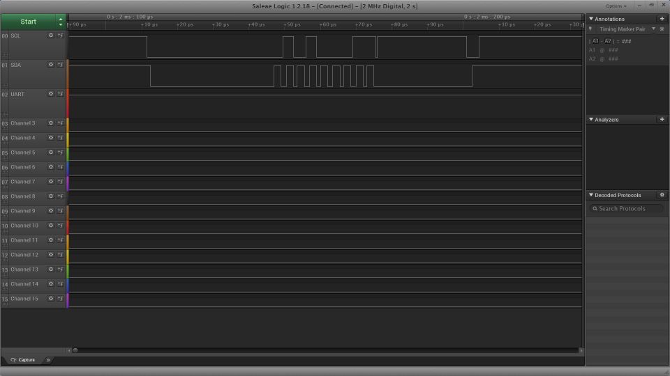

Arrgh... Well...progress...
With the help of this thread https://www.microchip.com/forums/m1020538.aspx#1022180 Post #8 ...
I proceed to change connections as stated (because I have the an Explorer board) and voila signals on the analyser akin to the expected..
Not out of the woods yet but .. still its progress. :)
Now trying to fix the errors... :?
Yes, the 0x34 was stupid, it was late and I was desperate. but now that I've got output confirming (I hope, haven't really looked yet) the start event was triggered. Although at first glance it looks as if the labels/pins are the wrong way round, I'd prefer the SCL at the top.
Now a very happy chappie :D :D

Postby ric » Thu Nov 21, 2019 11:03 pm
Yes, plainly SCL and SDA are swapped.
That trace shows an address of 0b01010001 (0x51) being sent, and a high (=NAK) during the ACK cycle.
The small negative glitch straight after the ACK cycle is unusual, I wonder if it's coming from the Master or the Slave. It occurs during the SCL low cycle, so doesn't affect anything.
