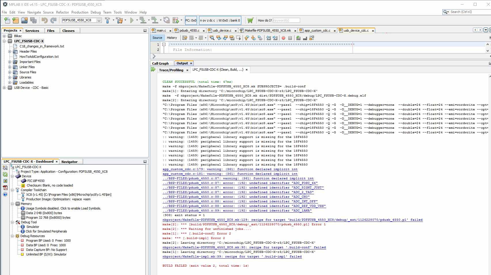

Postby Charon » Thu Mar 29, 2018 10:18 pm
Hi vloki,

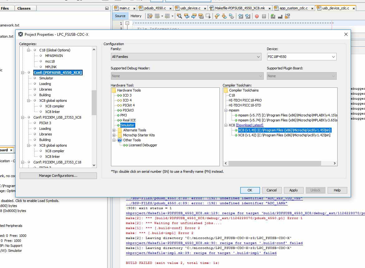

can you help me with location of source code? I installed MLA library on directory:
C:\microchip\mla\v2014_07_22\apps\LPC_FSUSB-CDC-X-r2\...
and build project in MPLAB X IDE v4.15, XC8 (v1.45) for PIC18F4550.
I test it with MLA v2013_12_20 and v2017_03_06 too. Without success.
my configuration:
Output showe me few errors:
Error Print Screen
Charon
Joined: Thu Mar 29, 2018 9:34 pm

Postby vloki » Fri Mar 30, 2018 9:45 am
Guess the main problem is that MCHP dropped PLIB for XC8 later than v1.34.
You can install v1.34 and try again, copy the source of the PLIB functions to your project
or rewrite all the functions coming from PLIB.
You can download PLIB from the same site you got xc8 from.
It wont work with the new xc8 version, but you get the source code for the fucktions.
Only two functions should be affected. I modified them recently for the 27J53.
