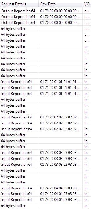

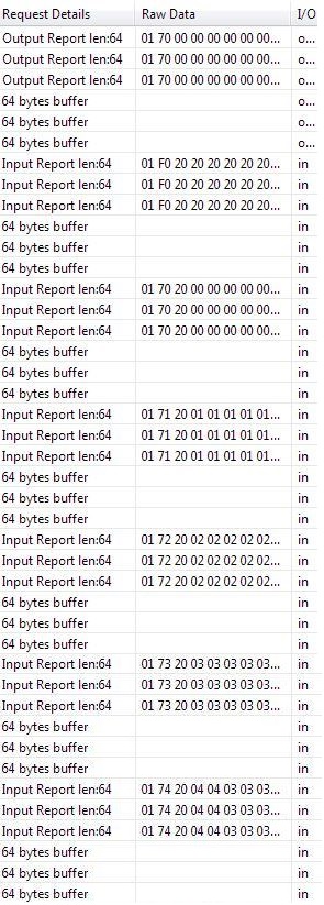

Postby susi » Mon Apr 04, 2016 12:11 pm
Thanx Vloki for the code.
I wrote what you said. It seems communication is doing. EEbytes2read = 250. There are 3 issues:
1--- By pressing the new button I get fig.1 result in sniffer:
fig.1 - usb port is captured by usblyzer after pressing button, for the first time
but when I pressed the button for second or third or ... time, the result changed. fig.2 shows it
fig.2 - usb port is captured by usblyzer after pressing button, for the 2nd,3rd, and more time
why the communicating data is different in these transitions?
2--- what does the packet "01 F0 20 20 20 20 20 ... " mean? I searched in commands list "F0" but there is no such a command.

Is there a special reason that all the transactions are shown three times?
2 - 0xF0 = CID_READ_EE | ID_MESSAGE; (0x70 | 0x80)
