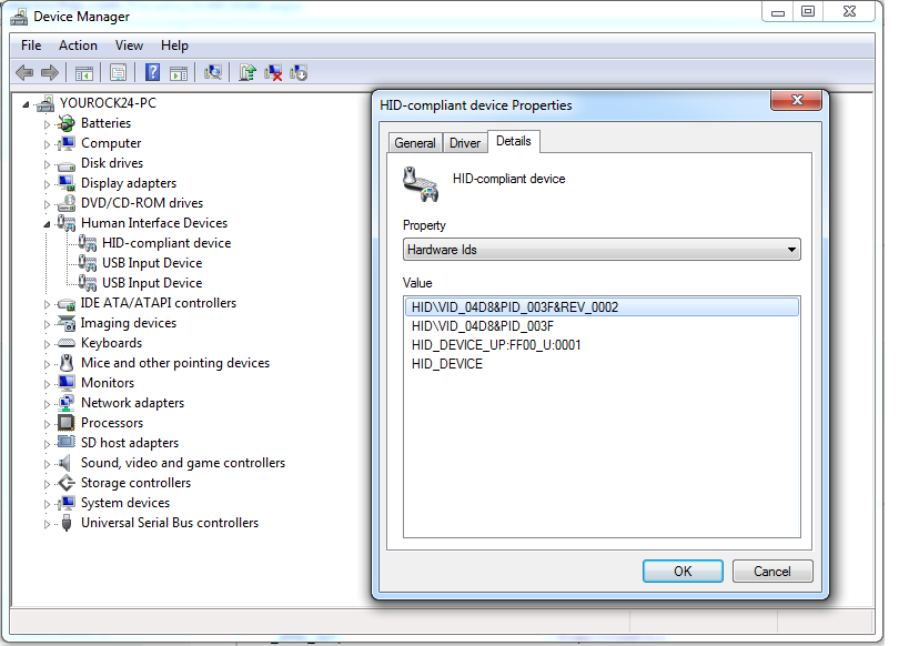

Postby vloki » Thu Oct 22, 2015 11:09 am
Does your device show up in the windows device manager?
(Like in this screen dump that shows a PICkit3)
