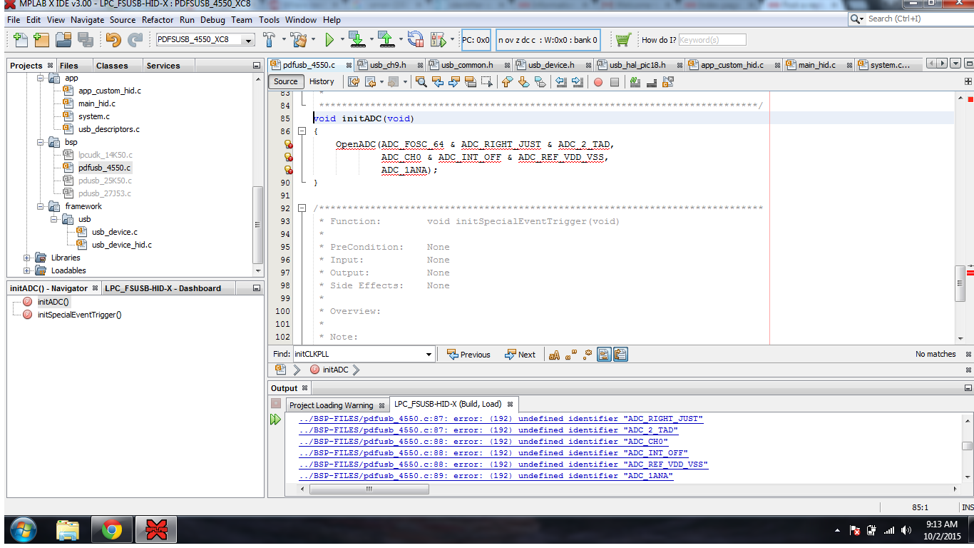

Guys please help, I've tried all my best to resolve this issue but I just can't.....I get some compiler errors , mainly related to the PDFUSB4550.C file, where these includes were commented
//#include <USB/usb.h>
//#include <USB/usb_device_hid.h>
//#include <ADC.h>
So I tried uncommenting the first two, got no problems related to them, I tried to uncomment the third include (ADC.h) thinking that may be the problem I get compiler errors, but it just added to the error pile( error: (141) can't open include file "ADC.h": No such file or directory)
I've atached a print screen with the errors I'm getting

Re: Simplified Microchip PIC USB demos (C18/XC8 MLA)
Postby imarian241t » Fri Oct 02, 2015 7:26 am
If I comment anything related to the ADC the project compiles with no errors, but this can't be right

Postby vloki » Fri Oct 02, 2015 7:45 am
xc8 compiler newest version?
-> You have to install the plib separately
(you will find them at the bottom of the compilers download page)
Postby ric » Fri Oct 02, 2015 7:45 am
I can't see any indication on your screen cap of which version of XC8 you are using.
If it is the most recent version, you have to download the plib files seperately from the compiler, whereas previously they used to come with it.
Postby imarian241t » Fri Oct 02, 2015 7:48 am
I use XC8 v1.35, is this causing me problems?
imarian241t
Posts: 7
Joined: Fri Oct 02, 2015 7:09 am
Postby vloki » Fri Oct 02, 2015 7:51 am
Yes -> http://www.microchip.com/mymicrochip/fi ... e=en574973
