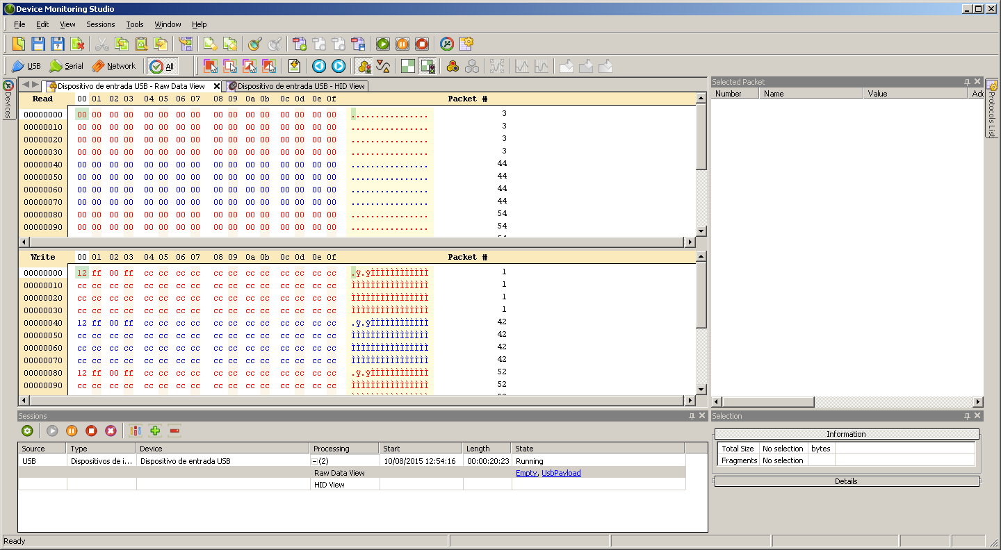

Postby deiv23 » Mon Aug 10, 2015 12:18 pm
This is the rawdata I obtain. The write packet is the one I'm sending, just setted the first bytes to 12, ff, 00, ff....

Re: Simplified Microchip PIC USB demos (C18/XC8 MLA)
Postby vloki » Mon Aug 10, 2015 12:26 pm
deiv23 wrote:I'll check it now.
Another question, where can I find the dlls for your Qt-hid demo? I downloaded a zip with all the source files, but I couldn't find the dlls.
The linked page some posts above does not provide any source files. Only the executable and the dlls ...
