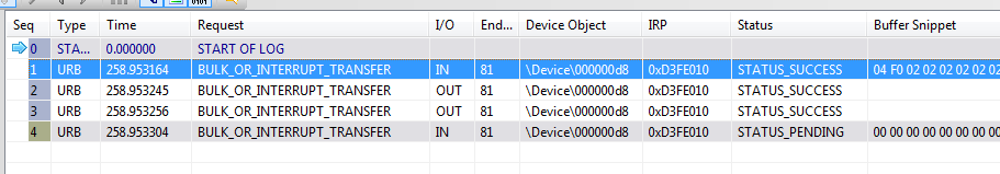

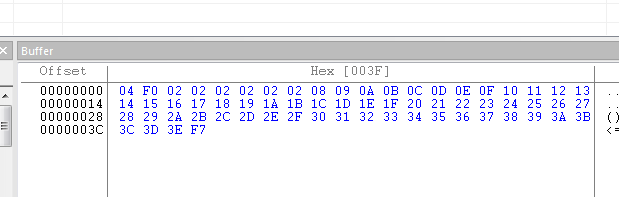

The 0xF0 is not recognized, I thought it was my VB programme that was wrong but it is not because I
have tried it with MidiOX and that reports "wrong format", I tried it with a Midi monitor and did not
work. The data shown on a USB Analyser is correct. So it must be the data from the 18F4550 that is

I don't know anything about MIDI, but the capture you show starts with 04, not F0. If you're seeing the correct bytes coming from the PIC, I'm not sure why you're suspecting a problem with the PIC. And I also vaguely remember that Windows inserts an extra byte at the beginning of a received HID packet before it's delivered to the application, is that being handled?

According to Midi Spec the first byte should be zero, I have tried this, viewing the USB output from commercial products that work they send this 04 then the F0.
