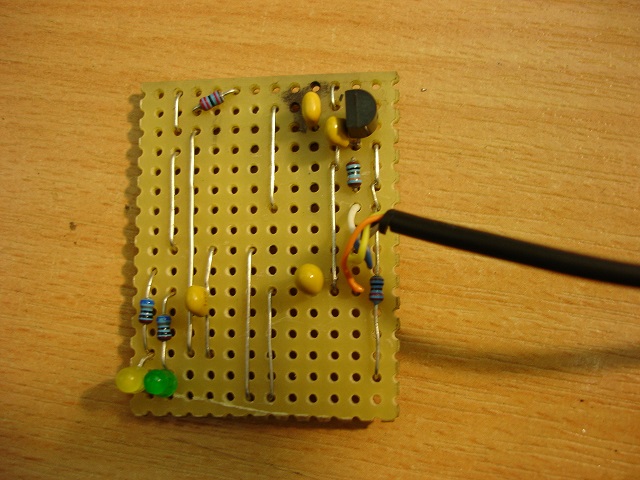

Next step is to start soldering links and components.
As a hint, I find it easier to place links on first. Remember some holes have two wires passing through.
This is the case for the 3.3V LDO regulator, the LEDs and a resistor. A small capacitor shares a couple of the LDO holes.

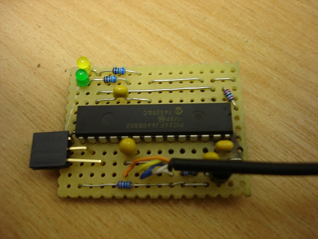

The PIC chip goes on last. Again I find the sketch makes it easier to work on the board without the PIC IC as a reference.
I was going to use my spring loaded program lead adaptor on this. But I couldn't get it to work well with the vero board so I soldered a header on later.
Note that some links are under the PIC IC. See 08:
Next power the board prior to placing the PIC on. Check voltages are what the're expected and there are no errors. Then solder the PIC on. See 09:
A connector has also been added for the UART signals. What can't be seen in this photo is that later I used tippex correcting fluid to paint the header and write the 0v/Rx/Tx on the side.

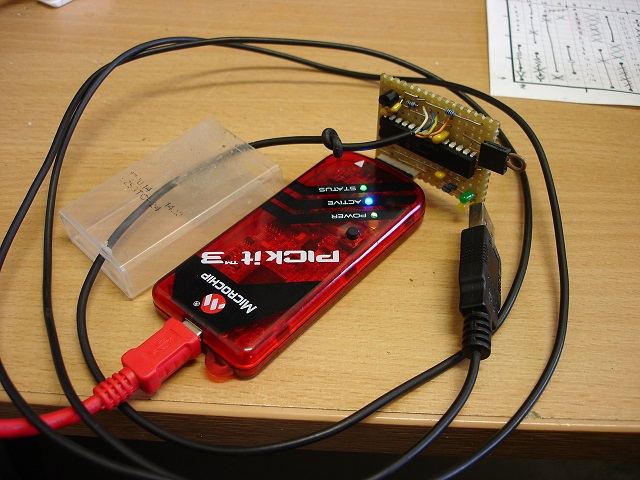

The converter was flashed by a PICkit3 with the HEX file shown in the first post. Note rather than a USB connector I have used a flying lead.
The one shown is from an old mouse where the cable became frayed at the entry point. A knot in it stops it being pulled through. See 10:
