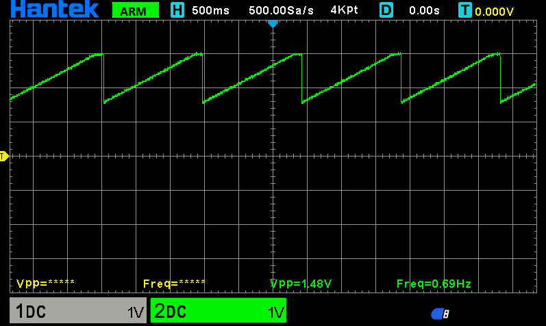

Hey everyone, I programmed a PIC16LF19156 to output a sawtooth waveform to a MCP4911 10 bit DAC and I have (unsurprisingly) already ballsed it up. Here is the output. It shows what you would expect to see except it doesn't oscillate between the full power supply range, instead it occupies 1/2VDD - VDD.
[img]Capture.PNG[/img]

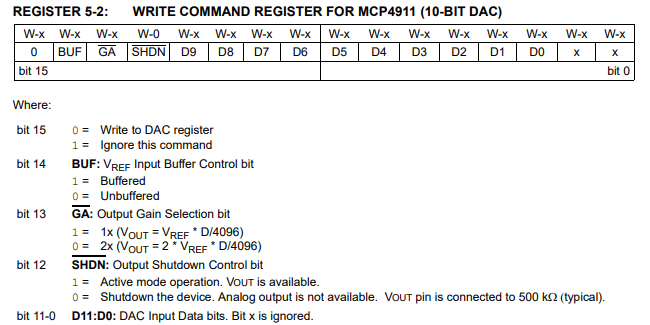

All the data is MSB first and here is the series of 16 bits the DAC listens for:
[img]data.PNG[/img]

Postby ric » Tue Aug 24, 2021 9:21 pm
This:
    //SPI SETUP
    SSP1STAT = 0;
    SSP1CON1 = 0b00100010;
gives:
CKP = 0; //clock idles low
CKE = 0 // outgoing data updates on idle to active, so rising edge.
that means the data is changing right when the DAC is sampling it, so it's getting shifted by one bit.
Change CKE to 1, so SSP1STAT = 0b01000000;
That will make the data change on the falling edge of clock.

Postby lucasc64 » Wed Aug 25, 2021 11:54 am
That was quick service, no buggering around! It seems silly now you say it, especially since I had the clock and data waveforms on the scope :roll:
Thanks so much!
