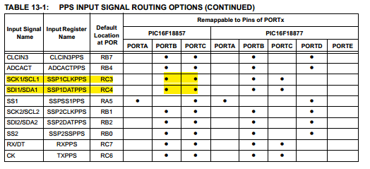

i tried to get the I2C on my pic16f18857 @ 3V3 running but i do not see anything with my logicanalyzer. when i drive the lines via the Latch registers, i see changing potentials (so no hardware stuff at this point). With the I2C i cant see any data and the debugger/the pic hands with the pending flag:
while(status == I2C_MESSAGE_PENDING);
Overview:
- SCL: RC5
- SDA: RC6
- Both pulled to 3,3V with 2k2
- the pic should be a I2C Master @ 400khz
- Adress of Slave: 0x80
Here is my config generated in MCC 3.15 (ported to the pic16f18857 from
the generated pic16f18854 files):

Here information for the mapping:
Bonsai
Posts: 4
Joined: Sun Jul 24, 2016 10:01 pm
Re: I2C not working
Postby vloki » Tue Jul 26, 2016 8:08 am
Notes:
Table 13.3
2: Each specific input signal may only be mapped to a subset of these I/O pins, as shown in Table 13-2.
Attempting to map an input signal to a non-supported I/O pin will result in undefined behavior.
Table 13.2
Note 1: Only a few of the values in this column are valid for any given
signal.
Table 2
4: These pins are configured for I2C logic levels.; The SCLx/SDAx signals may be assigned to any of the RB1/RB2/RC3/RC4 pins. PPS assignments to the other pins (e.g., RA5) will operate, but input
logic levels will be standard TTL/ST, as selected by the INLVL register, instead of the I2C specific or SMbus input buffer thresholds.
Did you try to use the default pins and see if that works?
If that works you may take the next step...
Re: I2C not working
Postby Bonsai » Tue Jul 26, 2016 8:25 pm
damn working now! hat one wrong number in the pin manager assignment... grr
Thanks!!
