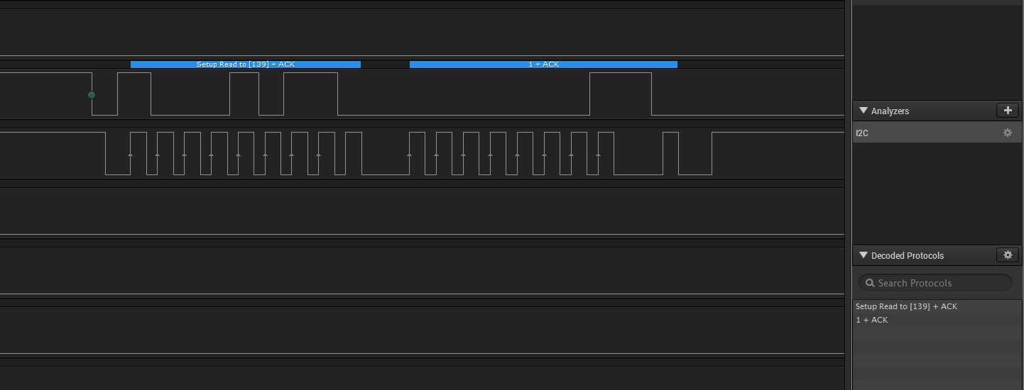

Short story: I want to make an encoder(slave). When a master require the data with how many pulses it counted, and interrupt is generated in the slave and data will be transmited via I2C. The problem is (I think the way I constructed the master) specially this SSP1CON2bits.ACKDT = 0; when this is off, the master recive the corect data, do not send the ACK (as seen in fisrt pic), this behavior in intended, the program run without an apparent problem.
My problem is when SSP1CON2bits.ACKDT = 1; the master recive the corect data, sends an ACK then stops, (see second pic) I think the master stops completely. Some how, somewhere I think I'm missing a register in wrong setting.
