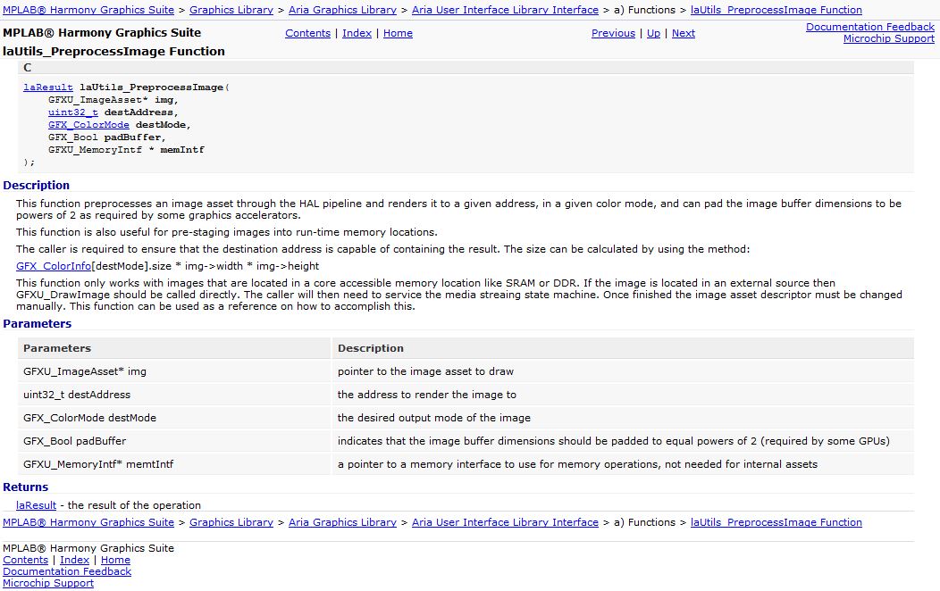

The fact that it modifies your passed in GFXU_ImageAsset is, of course, not mentioned in the documentation for the function:
This didn't actually fix the problem (still nothing but white in the imageWidget), but at least I'm a step closer to maybe doing this correctly.
