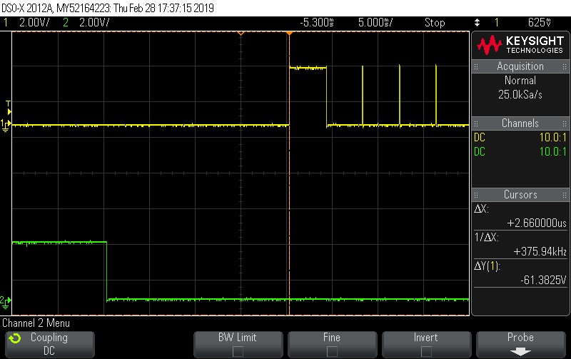

What I would see here is the switch would happen and I would get a high time (up to a full period) for some reason before dropping to the desired duty cycle This results in a nasty "flash" of the backlights jumping:
I don't really understand WHY this would happen, I assumed it had something to do with the CCP module buffering the new period value before putting it out, since a new compare value won't take effect until the next falling edge. What confuses me is that the previous compare value was to set the PWM entirely LOW, so why would it suddenly give me a high period before using my new compare value? This only ever happens when I turn one CCP module off, and the other on. I can zero the PWM and bring it back no problem provided there is no switching of the module.

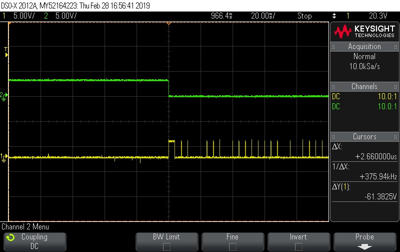

20mS was chosen just to make sure enough time has passed for the DC to settle. In reality a period of this PWM should never exceed 10mS. What I got was not what I was expecting:
I'm STILL getting a high period, which makes no sense to me, as during the delay, the corresponding OCEN bit should be low. The CCP module should be running, just not outputting.
So I'm at a loss now. Both as to why the module does this at all, and why my workaround didn't have any effect.
