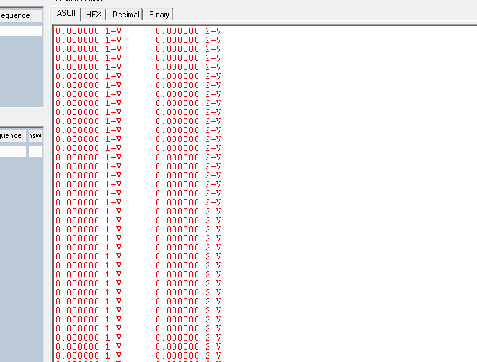

to see the result i included terminal programming it showing the output as 0 volts
am i missing something else please help me..

I need to read the 10K resistor voltage ...
Output looks like below attachment in terminal ...
