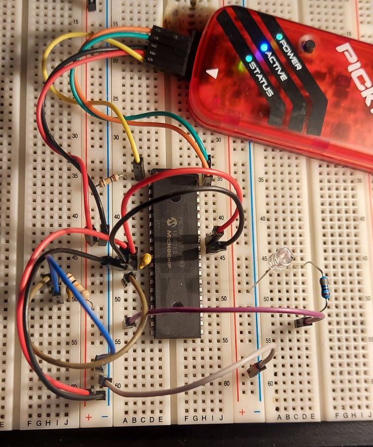

In the last few days I'm trying to set up simple program (blinking LED) with included configuration bits, in order to check if PIC responds correctly. I have already wired all needed components for this project: added R-C (10k, 22pF) to oscillator pin (OSC2/RA6), 10k pull-up resistor on MCLR, LED with 330R in series to RD0 pin and lastly PICKit3 programmer to all needed pins (wired correctly, I double checked it).
MPLAB tells me that it recognized the device via programmer, and the code is uploaded without errors (see pictures below). However, the problem might lie in me not setting configuration bits correctly. When I open MCC, there is no port A, B, C or D, where I could set them as I/O ports. But PIC18F452 has multiple I/O ports. So, how to I manually set these ports as output or input? Does this need to be defined in configuration bits area or in main.c file? If so, can someone demonstrate, what I should be or shouldn't be doing it this particular situation?

The RC oscillator components need to be connected to the pin OSC1, NOT OSC2, as per Figure 2-3 of the data sheet. This may mean that you do not have an oscillator running. (Note that you don't need an oscillator running to program the chip.)
Also I suggest that you add a bypass capacitor to ALL Vdd pins.

Geez, I did mess up thing by typing in wrong name of header file meant for configuration bits. I really thought it was something else, like not setting configuration bits correctly. I set it up correctly this time and am able to use it "all the way" (referring to pic below). It's all good now. In meantime I set up PIC16F628A, which also corresponded to my code correctly. I'm glad things are going much smoother now :)
Thank you for all the help I needed in such situation!
