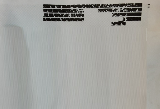

My programming is not bad. I tried to break my logo to 16 characters, e.g., {0x00, 0x01,..,0x13}. My problem is when I write a code like this:

where these hex addresses represents (in the micro thermal printer)

I saw the attached LOGO!, which is quite puzzling. Another image is my logo.
Can anyone tell me what is going on? BTW, I converted my logo to hex files by https://javl.github.io/image2cpp/.
My LOGO
download (46).png (846 Bytes) Viewed 15596 times
The printed LOGO!
