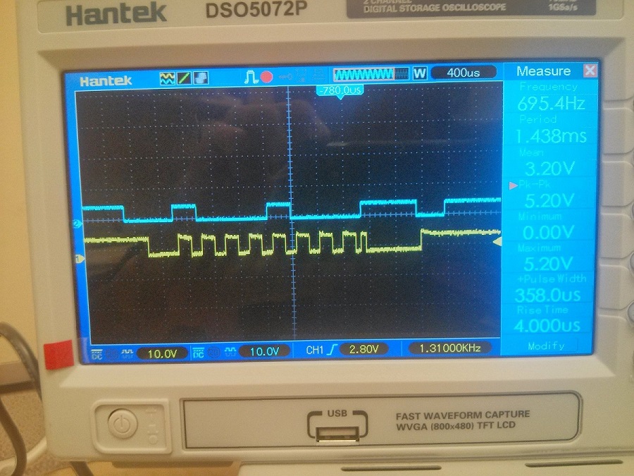

Postby zfeng » Mon Oct 09, 2017 7:56 pm
Hey folks,
Has anyone successfully interfaced this temp/humidity sensor with a PIC18F? I've been using Sensirion's sample code provided.
I'm using Adafruit's SHT31 breakout board which already has the 10k pull up/down resistors. I think I'm getting close to getting readings but I am stuck at the moment and not sure which direction to go. I am getting waveforms on my oscilloscope for SDA/SCL lines (see attached image). I'm trying to output the temperature and humidity readings to my LCD but I'm not getting anything.
I'm using error handlers to see where it's getting stuck. Specifically in the main while loop it stops here:
 //read status register
error |= SHT3X_ReadStatus(&status.u16);
if(error != NO_ERROR) {
LCDWriteStringXY(0,0,"Read Status Error");
}break;
Are my initializing parameters correct for the i2c and SHT31? Below are the main, i2c and sht3x source files. The project can be downloaded here (are external links allowed? The size was too large to attach here)
One thing I'd like to note is I have two delay functions. One is used for the menu and LCD files and the other is for sht31 and i2c files. I'm not sure if these two things might be causing a problem. I'll try to explore that next. Any help would be appreciated.
