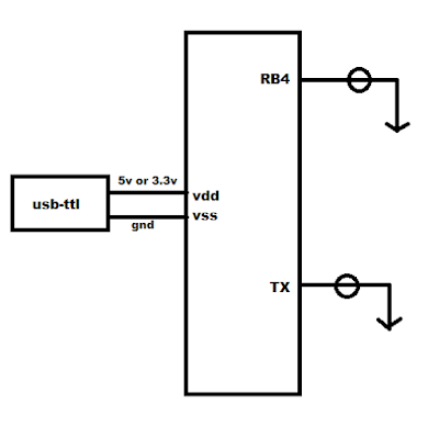

I also added LEDs to pins RB4 and TX to monitor the outcome.
Everything appears to function as it should when I connect a 5v battery the microcontroller.
RB4 and TX blink at startup and in sync.
However, when I use the TTL device instead of the battery, the chip appears to 'crash'. LEDs are at a solid 'on' state, or sometimes they don't turn on at all.

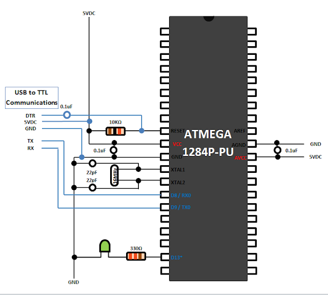

I began to suspect I may be connecting things incorrectly. I then found this schematic 'how to' for ttl devices and the ATMEGA1284 .
Could this be the case for my controller? If so, do you happen to know where I could find documentation for my controller?
Thanks.

Postby ric » Mon Aug 08, 2016 8:08 am
So you are attempting to power the PIC from the USB-RS232 module?
Have you connected to BOTH sets of powr and gorund pins on the PIC? You should!
Have you put a 0.1uF cap close to each pair of power pins on the PIC? You should!
("Close" means "electrically close", i.e. with very short wires.)
