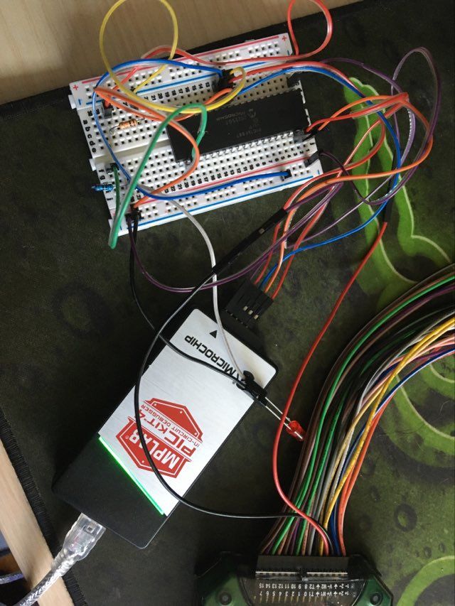

Hi, I'm trying to blink any pin on the Port D pins (I've tried the same method below on ports A & B),
currently have one connected to RD3.
It builds fine, it connects to the board fine.
But I get nothing on RD3 or any of RD0-RD7.
I'm fairly certain it isn't any of my circuit connections,
I've swapped out the chip for a duplicate to no avail.

Postby ric » Fri Sep 04, 2020 1:51 am
FOSC = HS
specifies an external oscillator. I don't see a crystal on your board. (See the comment on that line)

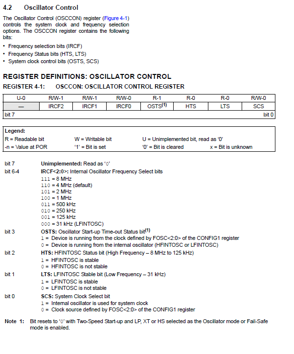

The register that controls the internal oscillator is "OSSCON", which I've now tried to define in my main() function, still isn't working. I've defined it as 0x75 because I want it to use 8MHz (0111) and I'm trying to use HFINTOSC as the internal oscillator with the 0101 (I'll attach register photo from datasheet).
Although still no luck.

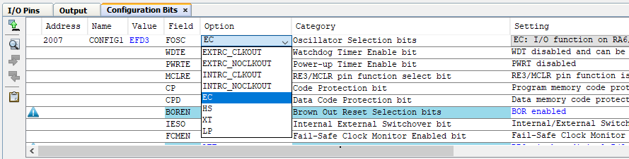

So, you must select an operaiton oscillator in the config settings. Try:
#pragma config FOSC = INTOSCIO

Go to the data sheet and look up Register 14-1 on page 206. Look at the FOSC field values - you need one of the values INTOSC or INTOSCIO (depending on what you want to do with the RA6 and RA7 pins). That will set the internal oscillator.
Look at Figure 4-1 and you will see how the whole oscillator is configured and which fields you need to set.
Remember that the CONFIG bits will determine how the MCU powers up. By setting FOSC=HS, you are saying that the MCU is to power up and use the crystal to clock the device right from the start. If there is not crystal connected, then the MCU will power up with NO oscillator running and therefore will NOT RUN AT ALL. Therefore, in your case you MUST tell the MCU to power up using the internal oscillator in the CONFIG setting.
Also look at the power-up setting for the SCS bit in the image you posted - it says that the power up value is '0' which is the FOSC clock source. This bit cannot be set except when code is running and therefore when there is a running clock.
gives an unknown configuration error. As it isn't one of the options
I tried to use a define statement for OSSCON outside of main, but that also doesn't work
