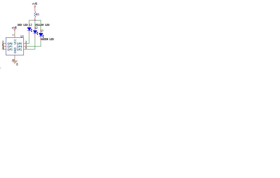

Hi All,
I have written the assembly program using MPLAB IDE 8 for microchip '12F675' to blink 3 LEDs in a sequence. Upon compiling and running the program on a circuit, only one LED (Green LED) blinks consistently as expected however the rest of the two LEDs (Yellow and Red) does not glow. In the circuit all the anodes of the LEDs are connected together to a 330 ohms resistor which in turn is connected to +5 volts supply. The cathodes are individually connected to the PIC microcontroller.
Please find attached the program that I have written: (LED.asm). Kindly request to review and let me know if there is any changes that needs to be done, to make this program work.
Need help, the attached program LED.jpg to glow(blink) 3 LEDs in sequence is not working for some reason.
Kindly request to review and advise.

I must admit I really don't know assembler but a few general debugging techniques might help you localise the problem.
Try running a program that simply turns on one of the LEDs. If that works for all LEDs then you know that aspect works at least.
If any single LED fails to light, check to make sure it is in the right way around - this in one of my common mistakes!
Next try turning on all 3 LEDs at the same time. I'm guessing that the current draw from all 3 LEDs might be a bit much for the single resistor and you are getting an excessive voltage drop across it. If each LED works individually but not all 3 LEDs together, then you should use 3 resistors.
If all that works then you have a coding error and I'll leave it to others to help you there.
Re: unable to blink 3 leds in a sequence
Postby Joseph Watson » Wed Oct 15, 2014 3:29 am
My take on things is that even if all three LEDs will not light at the same time when tested as AussieSusan suggests, the cause can easily be that they have different forward voltage drops, especially when different colors of LEDs are involved. Whichever LED has the lowest drop will get the most current and may even prevent the other two from lighting at all. Since the intent is to light only one at a time, a single resistor should work OK as long as the code sets up the three output pins properly. Still the suggestion that three resistors be used instead of just one is probably a good idea until you get things working correctly. Then you can return to using just one.
I see your CALL to 3FFh to retrieve the factory oscillator calibration byte. When calibrated at the factory, a RETLW instruction is stored at 3FFh to return the calibration value. However, some PIC programmers erase the entire Flash memory during a program cycle, including this special location at the top of memory. If this happens, your calibration value has been erased as well as the RETLW instruction intended to return it to your program. As a result, control will never return from the CALL to 3FFh. As a simple check, I suggest that you try commenting out the CALL 3FFh instruction and see if your program begins to run, even though its timing might be off a bit.
Good luck with your project.

Postby jtemples » Wed Oct 15, 2014 5:41 am
I don't know if it's the problem, but you have serious read-modify-write issues in your code.

Postby vinod » Wed Oct 15, 2014 10:53 am
Hi All,
The issue is resolved by ric
This is a classic example of the "Read-modify-write" problem.
Have a read of http://www.xargs.com/pic/c-faq.html#rmw and http://www.microchip.com/forums/m478014.aspx
In short, the problems happens when you use a string of BSF or BCF instructions on an output port register.
e.g.
; GLOW YELLOW LED
YLED BCF GPIO, 4 ; SWITCH ON YELLOW LED
BSF GPIO, 2 ; SWITCH OFF GREEN LED
BSF GPIO, 5 ; SWITCH OFF RED LED
RETURN
If GPIO,4 is high, the first instruction sets it low, but the second instruction is executed while the external pin is still switching from high to low, it reads the port first, sees bit 4 high, so sets it high again.
You MIGHT be able to avoid this by just adding some NOPs. e.g.
; GLOW YELLOW LED
NOP
NOP
RETURN
Otherwise you will need to rearrange your code to write the whole port in one instruction.
I thank everybody for their concern shown to resolve the problem
vinod
Posts: 2
Joined: Tue Oct 14, 2014 9:15 pm
