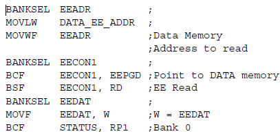

Hi, I want to store a value to the EEPROM of a PIC16f887 mcu. The code attached below is the asm code to read from the EEPROM. What does banksel mean and how to write the command in C for xc8 compiler. I'm not asking for the code, I just don't understand what banksel is for.
Thanks in advance

The registers in a PIC16F887 are accessed via four "banks".
BANKSEL is a macro that generates the code required to select a particular bank.
(it actually generates two machine instructions on that PIC. Newer PICs can do it in one, but the macro hides the details.)
You don't need to worry about it in C, as the compiler generates all the code required to access any particular register.
However, you don't need to worry about this low level code at all in XC8. The compiler knows how to access EEPROM memory directly.
You just add a "__eeprom" qualifier when you define a variable, and the compiler will generate all the necessary code to access it correctly whenever you use that variable.
